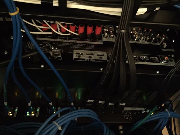

Anyway, here is a frontal photo of my current set up!
My installer has removed all the cables from the Amp apart from the speaker cables in disgust pending a further visit. I enclose below a screenshot of my Matrix Set Up which is working perfectly at distributing TV/Freesat/DVD to the four TVs with 'local' sound from the TVs. As I said earlier the HDMI's from my Freesat,DVD and Blu Ray are inserted in the HDMI Inputs of the Matrix.

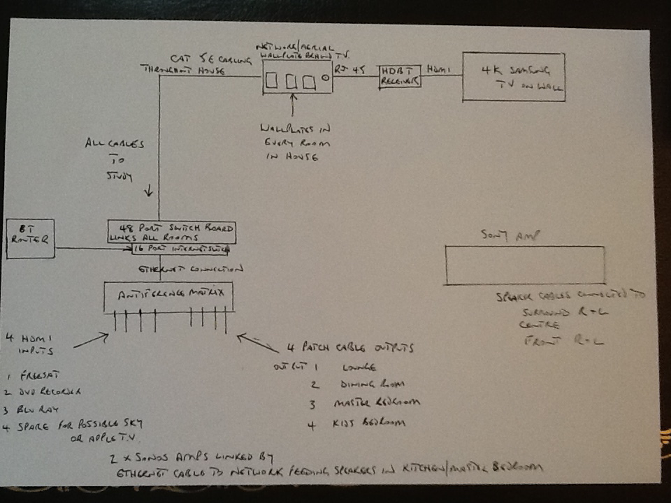

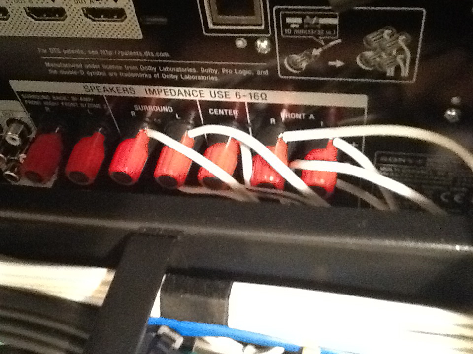

Hi Randy,
Thank you for your intervention! I enclose a drawing for your kind attention together with an image of speaker wiring to the Amp - that is the only wiring to the Amp at the moment - and details of the package contents of the Matrix.

Hi Poddy,
Thanks a lot for the drawing - much clearer now.
So if my understanding is correctly your sources are connected to the Matrix and then are distributed via Ethernet to every room in your house using the Antiference Receivers. These are connected to your TVs via HDMI and if I understood correctly video and sound are working fine.
Question now is where do you want to use the STR? Basically you just have to connect the STR to an Antiference Receiver via HDMI and then the output of the STR to the TV via HDMI. Sound should be played back then via STR and picture should be visible on the screen.
As speakers are currently connected for a surround environment it's normal that only 2 speakers will work if you input a stereo signal. If you don't need surround sound for your ceiling speakers you should use the front terminal only (pay attention to the speaker impedance). If you would like to hear surround sound via ceiling speakers you should select a virtual surround mode when you play back a stereo signal to have all speakers playing back music.
Hope that makes sense as a first shot.
Cheers
Peter
