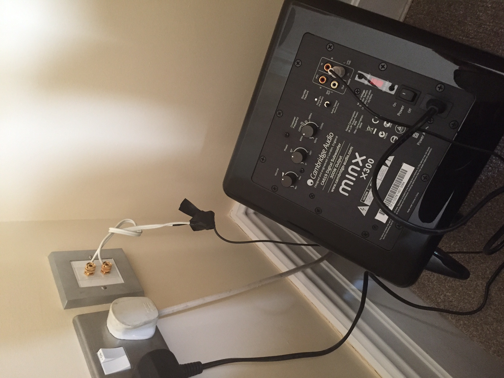

Sub Woofer
The 'first phase' wiring for the sub woofer was completed during the house build so all I can see is the wall plate (photos enclosed).

Reagrding Panasonic TV - well the next test I would propose is to exchange the "switching Panasonic" with another TV of your equipment to check if this effect is caused by the matrix or the TV itself. If the replacement TV is showing the same symptom I would asume that it's caused by the matrix or mybe the receiver.
In terms of subwoofer - OMG - this cable connection won't work. You need a shielded cable to connect your woofer to the amp. A standard speaker cable won't do the trick. Even if it would work you will have lot's of noise on the subwoofer signal. I asume that you can't change the cabling anymore - so in this case I would propose a wireless audio transmitter to transfer the signal from the STR to you woofer.

Hi Peter,
Thanks for getting back to me, I take on board your valued comments re the Freesat. My previous message to you got interrupted and lost with 'not authenticated' so my apologies for not signing off with courtesy!
Could you please elaborate with further comments, in layman's language, re the sub woofer wiring and point me in the right direction for a wifi transmitter ie a link?. Why won't ordinary speaker cables suffice? I presume that is what is behind the terminal plate in my lounge so presumably that is inappropriate wiring for the sub woofer? I do understand my Cambridge X300 is an Active Sub, not certain what this means and how is it different from an Inactive sub? I recall my installer showing reticence at installing my new Cambridge Sub Woofer - sounds to me like another reason to criticise the 'first phase' wiring built into our new home!

Hi Poddy,
The subwoofer signal is a low voltage signal at a high impedance - means very low current. Thus a speaker cable which is not shielded works like an Antenna and collects all the noise from you surroundings.
You can give it a try - take the RCA cable you have cutted plug it into the subwoofers input and put your finger on the middle wire of the cable - you should hear an awful noise coming out of the woofer. Same would happen when using a non shielded cable.
If you would use a passive subwoofer the wiring would be fine as you have higher voltages at low impedances.
The differences between an active and a passive subwoofer is that the active subwoofer contains an internal amplifier while the passive one is a simple speaker.
Anyway, I haven't found a simple audio transmitter - therefore you might have to use an AV transmitter like this one.
Hopefully this will solve the issue.
