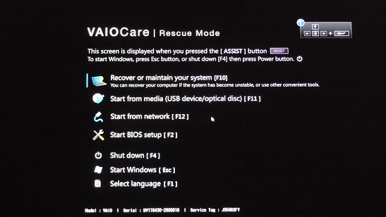

Hey gang,
How do I access the BIOS?  I have tried multiple key combinations from F1, F2, F8, F10, F11, Esc, Del.  Maybe I am not pressing it quick enough.  I cannot see any key combination stated on the screen to know what to press.  I need to check of there is an hardware acceleration/virtualization setting and if so enable it.  I am trying to use VirtualBox to setup a VM.

If you are using Windows 7, pressing F2 repeatedly when the Vaio logo first pops up should open BIOS Setup.
If repeatedly tapping F2 when the first black Vaio logo screen appears does not work try this:-
With the Vaio shut down and turned off completely:
Press and hold the ASSIST button above the keyboard until Vaio Care Rescue Mode loads
With the Arrow keys, navigate to highlight 'Start BIOS Setup F2'
Press 'ENTER'
This is usually for Windows 8+ models only but worth a try.

Turns out when the machine is shutdown I had to press F2 while pressing ASSIST which immediately goes into the BIOS.  There was indication of this on the screen and sites that I looked at did not give a clear enough indication rather suggesting I press ASSIST which launches the Windows tool and then pressing F2 which forme wasn't an option.  Going by another reply here this suggests that this may be Windows version specific.  This PC is running Win 10 Home.  All done and BIOS is updated. At least I know now.
