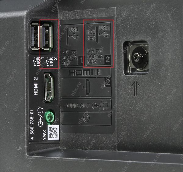

From my understanding, HDD recording is only available via the USB2 port - can you confirm that you have plugged the HDD into this port?
Also, try de-registering the HDD then re-registering it again.
