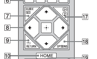

Hi "billycorby"
-Enter in EPG mode (GUIDE,7)
-Select event with “navigation buttons” (^,v,->,<-,+))
-Press OPTION (18) or i+ (17) button. (If event is not “running” yet, you can press even the central(rectangular,+) navigation button)
-Select option (reminder, record event, etc…)

Thank you for replying , I have tried this but doesn't work.  when I press options I get
All programmes
tv
radio
and no option to put reminder on event, and if press centre button it just goes to programme information
