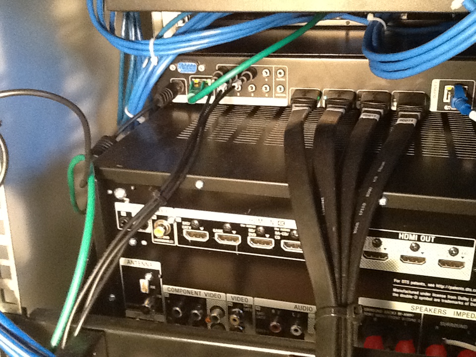

Firstly Peter,are you suggesting I utilise the 'spare' HDMI input 4 on my Matrix ( see the hand drawing I sent you previously) and connect this to my STR? If so, which "Output" do you advise I use on the STR, One Output,Output B or Output A ARC? (Does it matter which one?) Or do I use an 'Input" HDMI on the STR, if so which one?

As you can see my IR's for current 3 devices are positioned in OUT 1,2 & 3. Is your drawing suggesting they should be in IN 1,2,3 & 4 for the Amp?

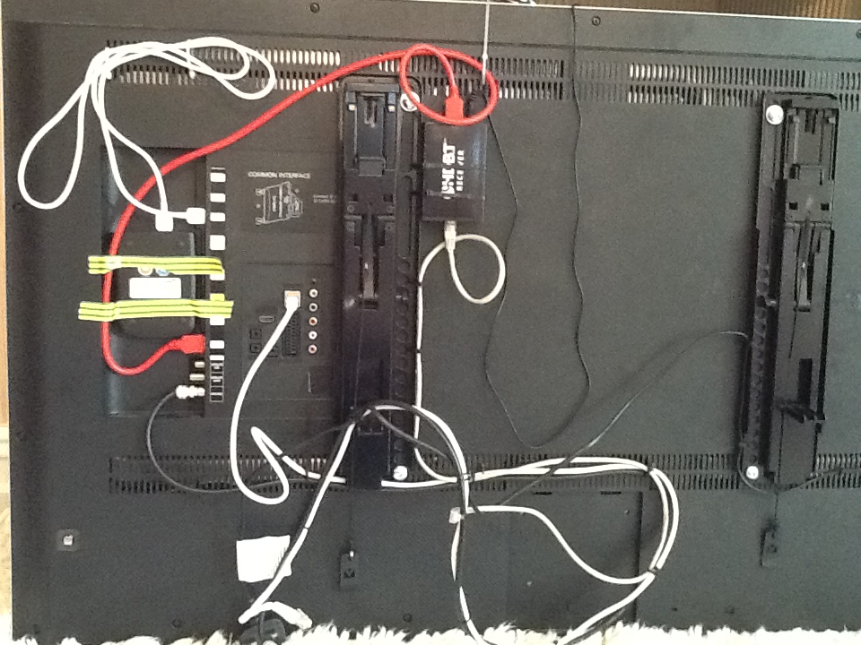

And I? Well, still confused sadly despite your best and patient efforts because my Amp is situated in my Comms Cabinet connected to speaker cables and the HDBT is situated on the wall behind my Samsung 4K TV. So the direct links you portray so eloquently by diagram omit my matrix. Which as you know are RJ45 connections! You are clearly one step ahead of me, ha ha!
I've removed my TV from the wall in the lounge and enclose photos for your perusal. I've identified the 'ARC HDMI 4' Port to which you refer but the only HDMI cable available to me is the one currently linked from the Antiference HDBT Receiver 'Out" to the TV HDMI 3 In (MHL) Port. Are you suggesting I simply remove one end from the HDMI 3 and insert in the ARC input on the TV?
Are you also simply suggesting I take the spare Matrix HDMI 4 Input and insert in the STR HDMI INput (Sat/Catv). If you are not then I am mystified how to use HDMI to link my STR to the TV? Should I resort to alcohol? Hopefully not, and once you've picked yourself off the floor from laughing..you can put me straight. Fingers crossed!

Photo of the data switch behind my TV and position of TV ....nb also got additional Data / Aerial switch at right hand bottom/below window for flexibility/table mounted TV configuration.

I see your problem with the different locations but you need to disconnect the red HDMI cable from the TV an plug it into the STR input. Then you have to connect the STR output with the TV input. Doing so you should be able to hear the sound via the STR.
Plugging the STR into the spare input will not work as you can't connect input to input.
What's the distance between your comms cabinet and your TV? If the distance is too big we probably have to rethink the strategy as the maximum HDMI cable lenght will be 49 feet.

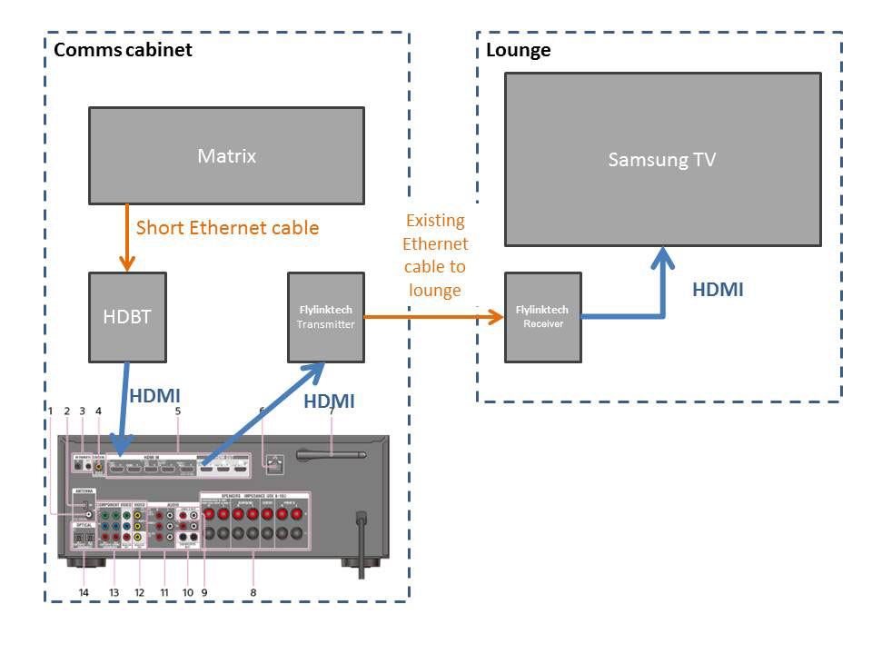

So here's probably a solution using some additional hardware in you Comms cabinet:
1. Remove the HDBT receiver from your Samsung TV an move it to the comms cabinet.
2. Use a short network cable and a HDMI cable to connect this HDBT receiver to your STR's HDMI input and to teh matrix output you've used before for your Samsung TV.
3. Use the transmitter of this set and connect it via HDMI to your STR's and the network cable to your Samsung TV.
4. Connect the receiver of this set to the other end of the network cable and then via HDMI to your Samsung TV's input.
Doing so it should work in the end. Anyway, there's one dis-advantage: You will not be able to control your Samsung TV via infrared remote signals - but of course you can control the STR (don't know if you use this function of the HDBT receivers).
Please let me know if this makes sense.
