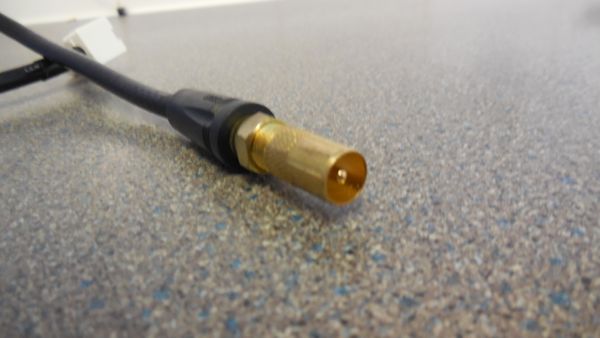

Once done, connect it to the AV Receiver and then the FM/DAB coaxial socket on your wall. This worked for me. However I will say that this is not supported by Sony, and dont hold me responsible...... Therefore do at your own risk.
Im also sure that there are many other ways that you can achieve the same results.
Good Luck and have fun

Hi there
Just to let you know - I have successfully converted the connection to coax (tested and works) Ill explain more tomorrow as im rather tired. But I used a satellite cable (then screwed on an F-Type to Coax adapter) which then connects into my FM/DAB socket on the wall.
