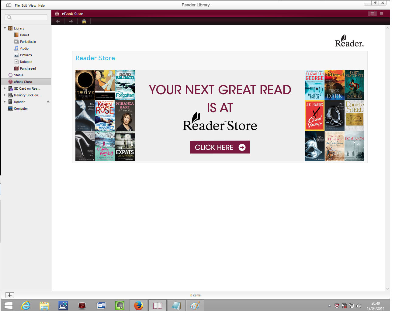

When I click on "eBook Store" I can see the Splash page with click here, but clicking on it does nothing.

If you haven't found it, the search terms "Register a Sony PRS 600" takes you to the Sony support section for the 600, where it shows an update from November 2013.
This may be of help.
Not quite clear if you succeeded in registering the device , but you would, I hink, also need to register your PC with Reader Store.
Sorry I have no experience of this model, but perhaps another member can help who may still be using one ?
Thanks for the reply. You are correct. Instead of using the Library software that comes with the reader. I went to the Sony download site for the PRS-600
Link is here: https://www.sony.co.uk/support/en/product/PRS-600
and followed the links through to the new edition of the library software.
Link is here: https://www.sony.co.uk/support/en/content/cnt-dwnl/prd-ebo/sony-reader-software-update-ver2200_11270...
Once I had removed the old software and loaded this one then did battle with Adobe trying to remember my old password, it seems to be working fine. It has registered my PC and my reader. So I should be good to go now.

Here is a screen dump of how far I get...
