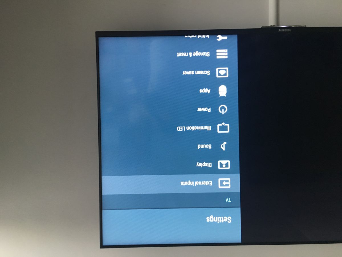

I have a KDL-55W805C, upgraded to Android Nougat - I no longer have the tv tuner capability.
It doesn’t offer it as part of the initial set up, nor as an input, not under TV menu (no channel set up menu)
ive done a hard reset, reinstalled the firmware (by usb), cleared storage - no joy.

The TV tuner capability, by default or after a hard reset, is provided by YouView.
Can you see, and choose, that option on your menus?

Sadly I have no menu option, under the tv menu(from the home screen), it lists streaming services- then the HDMI and av connections
Nothing for channel set up, Youview or any other.
A bit flummoxed!

But can you post a screenshot here, so we can see what you see when you put the TV on?

Apologies for the delay - here are the imagesHome screenHome screen
Settings->TvSettings->Tv
Channel guideChannel guide
Sparqui
But - they are upside down!!!

Can you not scroll up above that Apps line?
YouView Superuser, but not an employee of YouView, nor retained by them for this purpose. It's purely me speaking
Sparqui
Ny apologies- does this help?
Below appsBelow apps
External souresExternal soures
