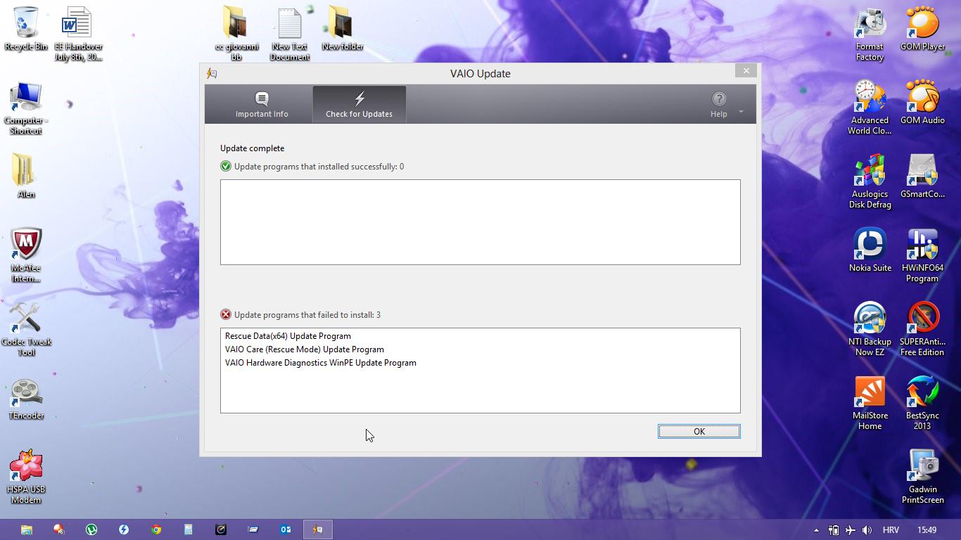

Hi All,
I have had a problem installing an automatic update, "RescueData(x64)UpdateProgram", for my SVE1513B4E. Other relevant data may be EP0000295598.exe, 2.8.1 - 2.8.1.04010; 10/04/2013
When the update tries to run automatically, after the computer restarts the update centre reports a failed update attempt.
I downloaded the .exe file from the Sony website and ran it manually; this time I get the message, "Cannot complete due to inadequate recovery area".

I can tell you that I had same problem. But after some investigation I success to install this updates.
I have this situation. Look the picture down. What I did is that I go first copy everything from Windows RE Tools (F:) disc. I am not sure that you can see this drive on your vaio, because I can see it all now. But I remember that before I didn't see it, but after formating they somehow appear.Ok long story. Copy all from mentioned above, and go to format that drive. After formating put back this files which you copied first. Go automatic update like usually and after restarting should be all ok. Good luck.
