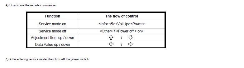

The way I know of entering the service menus is turning the TV on with the following sequence: I+, 5, Vol Up (or Down for another mode), Power button.
It won't help directly solve the problem, but it may provide a hint to what's wrong. Most of the info in the WiFi Monitor screen doesn't look terribly useful, but maybe the Miracast negotation fields could show something, or the WiFi Direct Status. But without being able to turn on the TV in Screen Mirroring mode, or entering the service menus when it's already on, I don't see a way to do it.
I thought Sony changed that, but then I looked at the 2013 R4 series manual, and low and behold - its still in their. I must be going nuts !!!
This is from the R4 Series:
