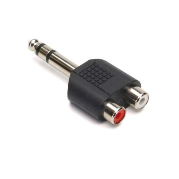

Without reading the whole thread, i too have a set of headphones that can connect optically to equipment, and like your Sennheiser, there is an option to use RCA jacks to connect as well. Somestimes i use the optical on my PS3/4, but mainly i use a RCA to Headphone adapter to connect to my AV Recievers headphone port.
So would this not be a better/easier solution:
Cheers
Not strange, as i too had this connundrum
At the front of you DN1040, you have a headphone jack:
At the back of the headphone dock, you have the option of optical or RCA.
If you connect these two from the RCA port at the back of the headphone dock to the headphone jack on the front of the AV Reciever, it will do the job.
I dont hear much difference in sound quality, but i do have a difference in my hearing from one ear to the other (too loud music when younger!)
But for the cost of less than a fiver - doesnt hurt to try an see for yourself
