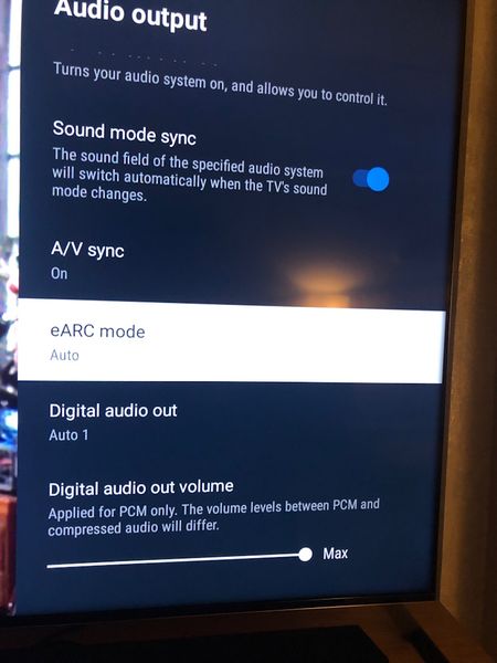

I've got eArc set to Auto on the TV:

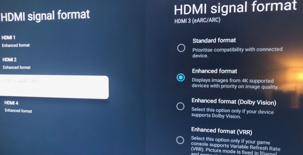

and the soundbar is connected to HDMI3:
I've tried this as Standard Format as well, without success.

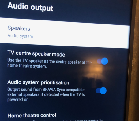

I've checked the audio output. It's set to Audio System:
Still no luck though. Although the audio does play through the soundbar, and the soundbar displays 'TV + eArc' when connected, it seems like there is something missing between the two devices. The soundbar remote works fine, which means I can at least change the volume. The soundbar doesn't switch on or off with the TV, so there's something amiss somewhere.

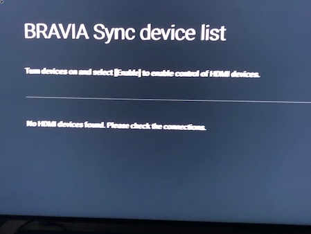

The soundbar does not appear on the Bravia list, even after I press enable:
which seems suspicious.
