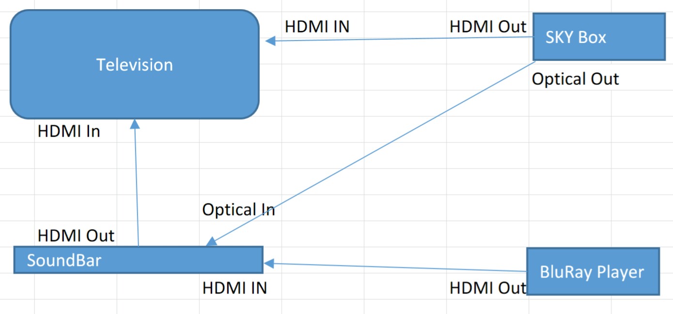

The soundbar is currently connected via the Sky+hd box with an optical cable and not to the TV (so all the sound comes through the soundbar). Surely the bluray needs to be connected to the TV in some way?
Sorry my fault - disregard what I said above - I forgot about the Sky Box
I have created this diagram below - this is how I would do it. A direct connection between the Bluray to the TV is not needed as the soundbar will output the video to the TV via the HDMI Out. Normally I would advise differently, but it appears that your TV does not have an optical out port.
Haha the TV is old (9 years) but I won't get rid unless I have to lol) So, avoiding to your diagram, which is excellent, thank you, I only need a bluray with ONE hdmi port as there's only one cable going into the soundbar and not two (which is the main reason I sourced this model) Looks simple enough to set up 🙂
Good luck with everything. Let me know how you get on anyway.
