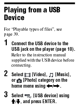

In order to use a connected USB device you must insert it into the front USB socket. The rear USB socket is reserved for the use of BD Live Content which you would need to connect a USB thumb drive too.
If you look at your manual (Page 20) it advises connection of a USB device to the Jack shown on (Page 10), this is the one on the front of your player. It's also worth checking the files types that can be played on (Page 39)
As far as size goes, 500 Gb NTFS is fine though Sony cannot guarantee that all drives are supported.
