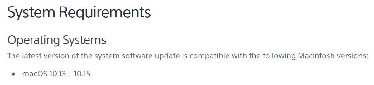

I'm gobsmacked. Below is the relevant extract from their v2.0 release only a couple of months earlier…
Screen Shot 2021-08-26 at 16.16.32.pngScreen Shot 2021-08-26 at 16.16.32.png

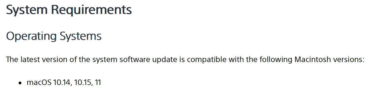

Screenshot_20210826-172832_Chrome Dev.jpgScreenshot_20210826-172832_Chrome Dev.jpg
Again, have you try whit the latest version of Imaging Edge for Mac?

Clearly - otherwise why change the wording? This is from the v2.0 readme:

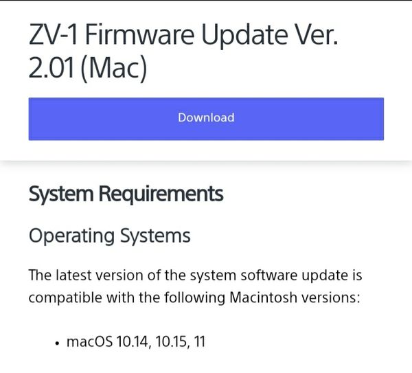

…and this is from the v2.01 file:
Screen Shot 2021-08-26 at 16.39.33.pngScreen Shot 2021-08-26 at 16.39.33.png
Marino.Manolo
Those are the compatibility for the software update program (System Requirements for updating).
I would try Imaging Edge, at the limit you get nothing.
